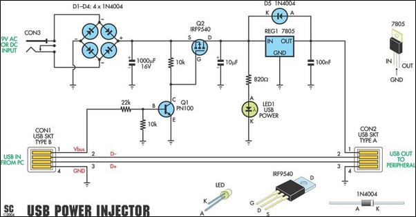

Δημήτρη για δες αυτο...
πηγη: http://www.siliconchip.com.au/cms/A_102685/article.html
