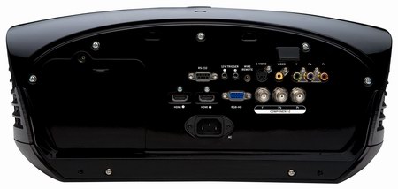

Video Support:HDMI and DVI with HDCP for digital video, Component and RGB HDTV (1080p, 1080i, 720p), Component and RGB EDTV (576p, 480p), Component, Composite and S-Video SDTV (576i, 480i), RGB SCART with adapter, NTSC/NTSC 4.43, PAL (B,G)/(D,K)/I/M/N, SECAM Computer Support:Digital and Analog up to 1920x1080 @ 60Hz, Macintosh® Communication:RS-232 (discrete commands and SW upgrades), IR remote, on-board keypad
Connectivity
(2) HDMI V1.3 with HDCP:HDTV RGB and Component, EDTV, SDTV, HDMI (High Definition Multimedia Interface) with HDCP (High Bandwidth Digital Content Protection), DVI via adapter (1) Component (3 x RCA, gold):HDTV, EDTV, SDTV, SCART RGBS: RGBS via component and composite inputs (adapter not included) (1) Component (3 x BNC, 75 ohm):HDTV, EDTV, SDTV (1) RGB (HD15):HDTV, RGBHV, YUV, EDTV (1) S-Video (4-pin mini-DIN):SDTV (1) Composite (RCA, gold):SDTV (2) 3.5mm mini jack:12V (+/-1.5V) screen trigger (250mA) (1) 9 pin D-subRS-232 for discrete control and SW upgrades (1) 3.5mm mini jackIR input for Niles/Xantech compatible IR repeater systems

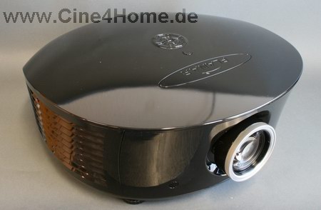

PD8150 features
Here are some of the features we offer in the new platform:
  • Stunning piano-black ID with metal-flake and multiple layers of clear coat
  • Oversized optics for superior image uniformity and clarity
  • Super low noise and light pollution cabinet design
  • limits stray light output to less than 50% of the brightness of projected black
  • Built-in sound dampeners
  • Shock mounted components
  • Angled side vent louvers to direct ventilation away from customers
  • Oversized fans for lowest noise level possible
  • Sleeve bearing color wheel for long life and silent operation and zero pure tones
  • Sixteen HD video timings; eight for1080p including 1080p 24Hz
  • Six position full HD PIP & PBP
  • Automatic ceiling mode detection
  • NegitivePulse lamp technology for increased color bit depth
  • Resize modes for 2.35:1 anamorphic lens use
  • Two selectable IR codes built-in, plus ability to disable IR
  • I/O panel illumination LED activated via remote
  • ISF day and night calibration memory settings
  • Ten individual sharpness controls
  • NightVision red backlighting on remote control
  • Lens shift controls under top mounted trap door
  • Threaded focus ring for adding Neutral Density filter
  • 12v trigger(s) that can be assigned to six separate functions -
  • Lamp on/off, 4 resize modes and RS-232
  • Four individual noise reduction controls
  • Calibrated to D65 standards out-of-the-box
  • Selectable DLP frame rate control – Auto, 48Hz, 50Hz, 60Hz
  • DynamicBlack™ for superior frame-by-frame black level adjustment
  • Adaptive contrast using electronic contrast enhancement
  • BrilliantColor™ for increased color brightness
  • Two lamp wattage choices - 4000 hour life and 2000 hour life
  • Auto-power on mode when AC is detected - Wall switch compatible
  • Five programmable source selection keys
  • Three programmable image memory selection keys
  • Eleven Built-in test patterns
  • Blue-only mode for calibration
  • Four level translucent menu
  • Lamp can be replaced while projector is ceiling mounted
  • Field upgradable software
  • Intelligent service menu for advanced troubleshooting
  • Serial number visible while ceiling mounted and via OSD
  • Sealed optical system and no filters necessary
  • Beveled cable cover for easy table-top demonstrations and a super-clean installation
  • Centered lens for uniform look and easier installations

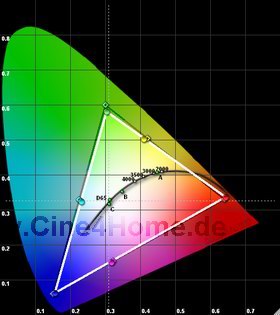

Απο οτι διαβασα θα το κανει τεστ ο Greg Rogers για το επομενο τευχος του WSR.
Εντυπωσιακα καλα ρυθμισμενος Out-of-the-box φαινεται ο προβολεας συμφωνα με τα διαγραμματα των Γερμανων!

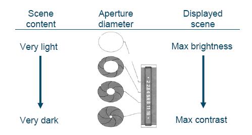

Here is a summary of the DynamicBlack process in the PD8150 and PD8130.
When turned on, full field contrast levels are boosted approximately 3x. To do this, 3 steps occur for every frame of content:
1. The image is analyzed for brightness content
2. If the image does not use the full range of brightness, the range will be expanded to fit the range of the DMD. This is similar to an auto leveling function of photo editors like Photoshop.
3. An aperture is closed to one of more than 200 possible positions so that the peak brightness matches the original (pre-expanded) image. This means that even though light is being blocked by the aperture, the apparent brightness of the image does not appear to change.
Because the entire brightness range of the DMD is used during dark scenes, DynamicBlack can add up to 1.6 additional bits to the image. This reduces dithering artifacts substantially so the clarity of the image is maintained even in dark areas.

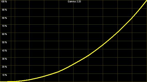

There are full controls for RGB gains and offsets. You can also choose from 5 different gammas. There is no look-up table access as we do not feel the control was needed. DLP devices are inherently linear and do not require recalibration of gray tracking at any time.
If you want more saturated colors than REC709 then you can switch to the native color gamut of the projector. This is only slightly larger than REC709, as we did design the product to be as close to a true REC709 device as possible.

The DynamicBlack aperture closes to its most-closed state during a fade to black. At this point the black level is about 1/3rd of what it would be with DynamicBlack turned off.
